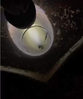

Do I need to replace this liner?
Chuck Pearson
Dec 9, 2005
52
Adrian, MI

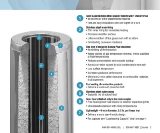

My chimneysweep says I need to replace the lower section of my liner because of a gap in the inner part of the liner. This is a double-wall liner with an inch of insulation between the inner metal and the outer metal. All of the load is borne by the outer metal. Since the insulation is still in place and there is no reason for the gap to grow further, I am skeptical that I really need to replace it, even though he would need to recommend that to be on the safe side. What do you experts think? One photo is of my liner and the other is the Security Chimneys liner design. Thanks.
[Hearth.com] Do I need to replace this liner? [Hearth.com] Do I need to replace this liner?
My chimneysweep says I need to replace the lower section of my liner because of a gap in the inner part of the liner. This is a double-wall liner with an inch of insulation between the inner metal and the outer metal. All of the load is borne by the outer metal. Since the insulation is still in place and there is no reason for the gap to grow further, I am skeptical that I really need to replace it, even though he would need to recommend that to be on the safe side. What do you experts think? One photo is of my liner and the other is the Security Chimneys liner design. Thanks.View attachment 261214View attachment 261215
Yes that section of the chimney is shot and needs replaced without question. And just a correction what you have is not a liner it is a prefab chimney
