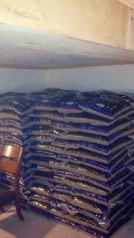

There are 6 tons in this photo. I do not see how unbagging them and adding a storage silo will decrease the floor space used.

Nice stacking.
I have never got more than ~2.5t in my basement before the silo, the unfinished part is not large. I also used to stack the bags on pallets with heavy duty wheels on the bottom as I was worried about damp and I have a water filter and many water /vent pipes above that area. The silo goes just short of the ceiling, lining 2 basement walls and forming a third and fourth wall to the ceiling. If the silo was not there I should get the 3+tons in there.
I count those bags stacked 15 layers high. Are you not concerned about the bottom bags getting crushed? I've spoken to reps at the mills who've said that pellets should not be stacked more than one ton. They may have been referring to palletized bags but weight is weight whether they're palletized or not. I've seen crushed pallets in bottom bags before and I stack mine no higher than 8 layers.
I`ve been stacking 15 high for years and never had crushed pellets, (yet ).Or at least I haven`t noticed.
I wonder if it helps that my pellets are stacked on a carpeted floor.
