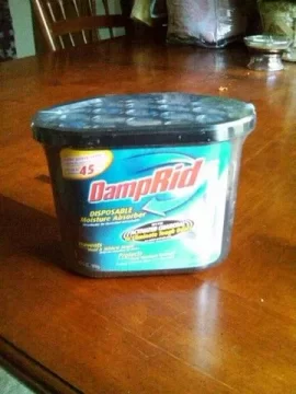

With pellet stoves, I have always "Plugged my Flue and my OAK's. To keep the humidity coming in from outside. I use old rags, followed by a bag or plastic of some sort. Follow by some tape, that is tightly wrapped around it. I then put a desiccant in the hopper and in my ash pan. That sucks all the moisture out, that may want to get in there. The one upstairs is in the Central Air Conditioning. The Fahrenheit and the Englander 30 are in the basement. Basement I run a Dehumidifier and have Desiccants down there also. The desiccants I use are called "Damp-Rid" they are pretty big and can handle all the moisture a stove will dish out. Don't know if anyone has put one in there woodstove before. But I use them in my pellet stoves and will continue to use them in the woodstove also.
