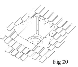

The chimney support is attached to your ceiling joists, the chimney system just passes through an opening created at the time of installation. Flash, collar, add exterior roof brackets as/if needed.
Sometimes this depends on the interior ceiling construction and desired finished look. Both methods work. If the intent is for the chimney to be roof supported, the flanges can be bent over and nailed to the roof deck before the metal roof is installed. This works well when there is only one ceiling joist to nail or screw to.
This is from DuraVent's install instructions:
[Hearth.com] Do you have to install all of the chimney?
