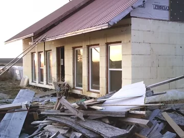

I'm building a small house, zone 5, Idaho, but I don't know the heating/cooling requirements of it yet. I'm doing some passive solar concepts - large south facing windows, windows inset, internal thermal shutters, and black thermal mass to absorb sun. I found some big black porcelain tiles at Lowe's.
The color black can absorb the sun's energy the best - it is surprising, it is like twice as effective as some lighter natural colors (so twice the heat energy). How much heat input into the house directly from the sun? I'm not sure.
My second form of heating will be from a masonry heater. That's it. If I leave on vacation I will need to plug in a heater.
A 3" or 4" dark masonry inner wall is supposed to work best. The wall absorbs the sun during the day and after the sun goes down (shutters closed) the wall radiates the heat into the living space until the cycle begins anew. Moreover, water is superior to masonry in collecting heat so I'm going to try to incorporate some metal black 55-gallon water filled drums into the inner wall (they'll be hidden). Worst case scenario - this house completely heated by the sun. This would mean no burning in the masonry heater unless cloudy or very cold. Here is a picture of the outside.
I used the very dark grey as opposed to flat black on the floor ,was considering going halfway up the wall since the sun shines halfway up the wall Dec 21,but ultimately just did the floor. They still get up to 140 degrees F while the sun is shining. Cant walk on them in bare feet. If id done the wall too it probably would get too hot in that room.
Goes up to 120 on a sunny winter day.
