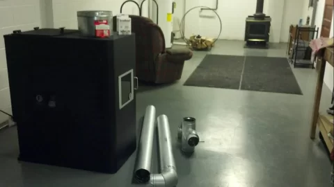

Installing my Fahrenheit furnace today. May not get it done, as I have ran into some little problems. But should be done in a few days (complete install, including ductwork)

Congrats on the stoves.. Here is a pic of my 2nd stove (still working on it/gonna take a few days/need other parts).

Nice looking stove! Good luck with the install. I'm sure that baby will do you well! I am looking forward to figuring this all out. I think even better than the money savings is the fact that I am not giving my money to big oil. I would rather spend my money on pellets that I know are made in America! As soon as I get the tankless hot water heaters, I can pretty much ditch the oil furnace all together. Now I just have to figure out how to keep the basement warn so the pipes don't freeze.

Use the search function at the top pf the page if you have any general questions. A product known as Thermgaurd may work for application? Do a search and take a look at it.
As for the furnace I am hoping it works. Im only feeding into one line of ducts. Its basically split into 2 main lines, the South side, and the North side. The bedrooms, bathrooms, and kitchen are fed by the North line. Thats the side I am tying into. The South side is the Family room, dining room (where the Quad is), and Living room. Going to put both on programable T stats. So the Quad starts up in the a.m. 1 hr before the Fahrenheit is programmed to shut down and have the Fahrenheit start up 1 hr before we go to bed in the evening, before the Quad shuts down. So for only 2 hrs will both stoves run at the same time. Or thats what I have in my head.. May be nothing like that. Only time will tell.
