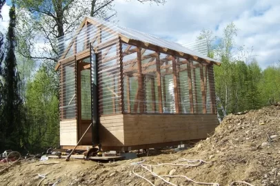

Sorry - I can't resist asking for more details about that greenhouse. I NEED one! Any tidbits you can share about construction, things you might do differently (if any), etc. would be greatly appreciated. I have wanted one for a while, but was concerned about construction quality of the kits I could afford, and I don't have the time and money to try and figure it out myself by trial and error as I figure I would land more on the "error" side ;-) If it works for you in Alaska, something like it should work over here in New Hampshire...

I built a 2' high base, 24" centers, outside is 8' X 12', opening at the front for the door (32''). covered with plywood.
5 pieces total: 2 @ 2' X 12', 1 @ 2' X 89" & 2 short ones so front opening will fit a storm door.
set a treated 4X4 into the ground/gravel flush to top of 4X4 all the way around to nail the 2' walls into.
5' high wall frame on top of that. Front wall framed for door opening.
Drew out the barn style truss shape (7 total) on the floor with chalk, cut short pieces close to the angle, plywood across the joints .
Frame one end truss for a fan. Set both end trusses, 2" in from the ends so plastic sheets will overhang the ends by 2".
Wiggle molding & 26" X 12' greenhouse plastic screwed on. 1st piece centered top-middle & work your way down the sides.
cover the ends, cut out for fan, install the door. I used treated 2X4s, cheap storm door from Lowes, Sun tuff Greenhouse plastic with green screws
Fan up high, vent louver down low on a thermostat.
No plans, just started nailing/screwing wood together. Handles wind well.
This type (below pic) handles snow load well, I built it for buddy in Willow, he set his on pier blocks & treated 4X6 then backfill the outside with gravel :
Just different roof, ridge pole & then nail on 2X4 trusses
