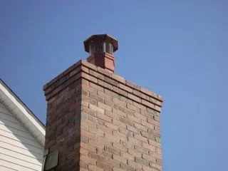

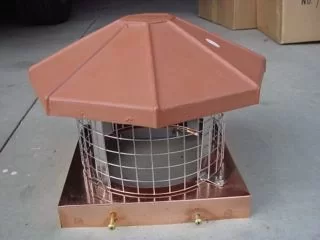

In terms of style, there is a lot you can do to make it look better than the normal liner rain caps. You can use a regular masonry chimney cap and terminate the ss below it. If you don't like the style of the standard chimney caps, I have some semi-custom stuff in the shop which may be able to help you. If you have interest let me know the size of the flue tile.
Examples enclosed.
[Hearth.com] Does a round stainless steel liner require a rain cap? [Hearth.com] Does a round stainless steel liner require a rain cap?
Yeah. Not putting a cap on it would turn the liner into a five inch diameter rain gauge. Right into the stove or tee.
Birds, bats, etc., too.
