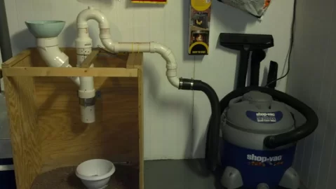

    Here is a pellet vacuum video on YouTube:

    I did one of those homemade PVC Vac. units and was not impressed (good if it works for other people ) with the results.(clogged a lot with subpar dust removal)IMO.

    The first 2 years I had my stove I used a setup similar to the YouTube video. After that I got lazy, said screw it and I just dump them in.

    Ok... I will bite. All that say they don't need one.
    Naysayers ;). Quads dont a screw and cylinder type auger. Its an open spring. Which DOES NOT bring fines up the auger flight. So the fines build up and it lowers the feed rate on All Quads and Heatilators.
    The Hopper will need Vac'd if you don't Sift.
    Sifting also catches any foreign material. If you have burned pellets long enough. You have found a Bolt, Screw, Piece of wood, Rubber, Corn, Etc in your pellets. It happens. Pellet manufacturers are far from perfect :)

    OMG. I can't even imagine beginning to construct that. Let alone have the space to put it!
