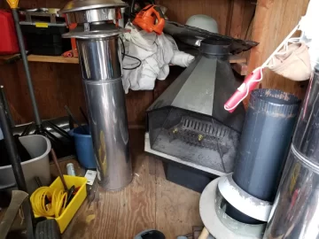

Does anyone know what kind of fireplace this is?
firewaterfarm
Jun 29, 2014
28
RI
Does anyone know what kind of fireplace this is? And would it give off a fair amount of heat for a small cabin? Or is it an inefficient type of stove? Not expecting it to give off the type of heat as a traditional wood stove would but wondering if it would be able to heat up a small space.
  • [Hearth.com] Does anyone know what kind of fireplace this is?

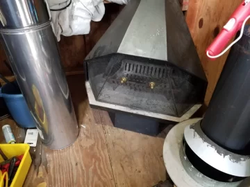

If nobody knows what brand of fireplace this is could someone tell me what kind of heat they think it would put out?
This is for sale on craigslist for $150 and I'm thinking of picking it up for at least the stovepipe
Looks like a Malm copy. From the looks of it this is a fireplace designed for the fire view mostly. It will heat, but not very efficiently or cleanly.
