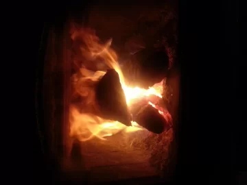

Sorry for the sideways pic. The left is actually the top of the fire box. They are rolling flames sepearated from the wood. There doesn't seem to be any flames actually coming from the tubes? Its dark when I get home so can't Check to see if the chimney Is smoking or not. I can this weekend though. Just trying to decifer a clean burn from a less desirable one from the looks of the fire.
How close to closed do you have the air control?
I have an average (not overly tall) chimney and for me, when the stove is cruising I probably have the air control about 5% to 10% open yet. Too much more than that and the air the chimney is looking to pull in will come through the air wash over the glass and feed the fire, and the secondaries won't feel as much pull to make them light off.
Focus more on setting the air control for a clean burn, and less on secondaries.

That's with the stovetop at 600 and the air at about 10-15% open. Should I make it a goal to have those burning or is what I see fine as long as there is very little smoke coming out the chimney?
If the air is only 10-15% open, and that stove top is at 600, it sounds like you are doing well.
Usually people who are having a problem have the air 50% or more open, and can't get the sucker over 350 easily.
Well done, you are fine.

So is it safe to say there should be very little flames coming off the wood when the air control is set correctly. The majority of the fire should be up around the tubes?
I find it depends on how much wood is in the stove, what the outdoor temps are, how I loaded the splits, etc. Sometimes there are more visible secondaries than others, sometimes more of the flame is on the wood, it simply depends.
In the end, so long as the flue temps and stove top temps are reasonable, along with the burn time for the fuel provided and the size of the stove, then just enjoy what is seen through the glass and don't get too worked up,,,, regular inspections of the flue to make sure deposits aren't building too quickly also help keep the mind at ease, even better yet, just run the brush though (even as much as monthly if you are worried) until you can get a feel for things.
