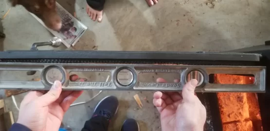

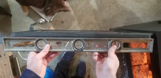

Here are two pictures of the top of the door. I can take more but will have to wait until the box cools

Take a few with the level against the stove, there was a member here that returned (2) of these stoves due to warped fronts, there was an issue with the summers heat line, but it did not effect the Englander NC30 line, if the stove body is warped I'd return the stove on warrantee, either get the like of like stove but measure it at the stove store or get a full cash refund and order a Englander nc30.
A little hard to tell, but that top picture certainly appears to show a bow in the door. When you did your dollar bill test, did the bill slide easily in the center of that top edge?
