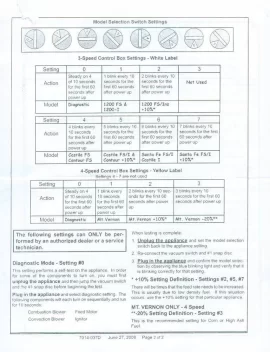

Loosening the nut did the trick for the trap door. The tech found that the control box was set to 6, instead of 4 (normal) or 5 (+10%). It's set to 5 now, and the flames are up 2-3 inches out of the burn pot. Still not 4-6 inches, but better. Maybe the air flow isn't what it could be thanks to the long cold trip up the chimney. I'm going to relax and not worry about it for a week or two while I burn through a few more different brands of pellets and enjoy the Christmas holiday. Peace and joy to all y'all and your families!
Good on loosening the bolt! It's probably a good idea to get the hang of the stove at this stage and play with the feed rates a little. 5 setting is right for +10% for a free standing or insert Castile. 6 was the CORRECT setting for a normal setting for your insert. That's what I use. I don't know why 7 would give 10% for a Sante Fe but 5 would give 10% for a Castile when they are essentially the same.
Yeah, I never understood why the setting for the Castile FreeStanding is 4, the Insert is 6, but both Castiles use 5 for the +10% feed.
