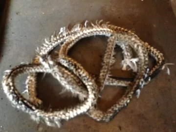

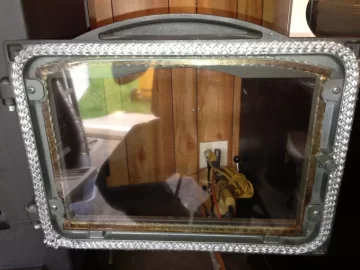

Pic 1 - Frayed and dirty old white rope gasket

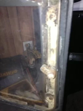

Pic 2 - Dirty area next to door gasket and dirty old door gasket.

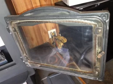

Pic 3 - Dirty cam latch and dirty rusty screw heads and tabs that hold in window glass

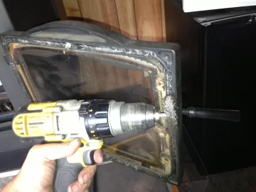

Pic 4 - Wire wheel and drill drive used to remove all the old gasket and scrub off rust and dirt!

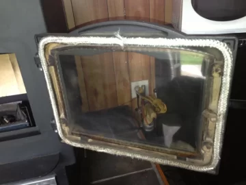

Pic 5 - Door is now clean but does not look as nice as it could.

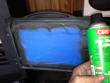

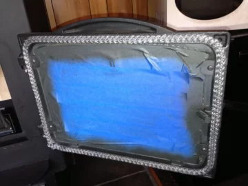

Pic 6 - Glass was masked and a little Dry Moly Spray was used to protect from rust and look newer.

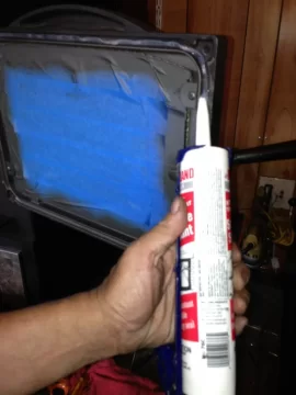

Pic 7 - Using Clear High Temperature Silicone holds the new gasket in and is easy to use.
Pic 8 - New Graphite impregnated door gasket installed starting in lower left hand corner.
Pic 9 - Masking tape removed and glass is cleaned. Molly dries fast and door should be left closed overnight for silicone to cure.

One has to be sure to let the silicone set before closing the door. The rope will become impregnated with silicone and become very stiff, from experience.
Do you need to put any pressure on the gasket while it drying? I thought that was kinda the point of closing it loosely. Ive never done it just guessing I have a new gasket Id like to put on my stove. Thanks..
if you spray dry molly and then cement in the door gasket, aren't you worried the gasket wont adhere?
I did not spray the dry moly in the gasket channel.
Best thing to do is close the door tight with newspaper in it so any excess RTV will not make the door glued shut.
Use gasket cement if you want to close the door while drying. Silicone is a different animal. Actually you can use silicone and close the door if you don't use half of the tube. It's hard to know how much is enough sometimes.
That takes experience Scott. I use high temp Silicone just like many OEMs
If you shut the door and are worried that the silicone will stick the door shut you have used WAY too much silicone and your gasket will become totally stiff when it gets heated.
I don't dry molly anything on the door.....frankly, the only thing I'd consider dry mollying on the P61 would be the burnpot wingnuts, the rotating latch for the combustion fan cover, the combustion fan impeller set screw, and, well, that's about it.......
Cleaning the rust off the bolts that hold the glass in and spraying dry moly on, keeps them from rusting.
That is true, the newspapers is just a nice precaution for one small spot. I have seen cement and furnace cement used. (furnace cement is a big no no) but when hi temp clear silicone dries it is still flexible so it is still the best to use.
Actually, black mill pack is the best to use, clear is only rated to 500 degrees and red looks messy.
Yes that is true but some people like clear because it does not show.
That's why one would use black, cause it doesn't stand out
It only does not stand out on black stoves! I did a Mohave Red stove with the same tube for clear color! LOL
