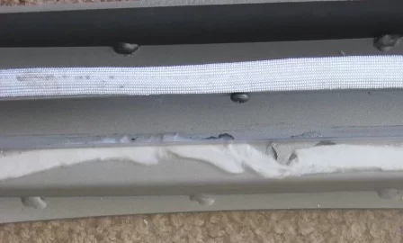

Looking for input on stove glass gasket material. The one on the Nestor Martin X33 door has blown through in a couple places. The original is made from a flimsy, flyweight material (maybe long-fiber ceramic wool?), diecut (talk about material waste!), 1/2" wide and compresses down to almost nothing even with just the glass' weight on it.
Local stove shops only carry the "flat" braided Rutland gaskets, which are very nice but are all too thick. The brackets that hold the glass in place don't have that much play in them.
Any ideas on alternate materials that might work?

Hey there Precaud. Yeah, I thought that might be braided. Perhaps slice some thin ceramic insulation? Or maybe look into some high temp ceramic tapes by 3M? Nextel 312 is about 2 cm x .5mm and very high temp. Problem is that it's sold in big rolls for wrapping high temp pipes. Know any steam boiler guys or someone working on outer space equipment? :) Los Alamos surplus?
The lower gasket in the picture looks to be ceramic fiber paper or blanket. You can probably buy small quatities off of a local refractory distributor or online with McMaster Carr
Yeah, I think improvising with ceramic wool might be the place to start. I have a roll of 1/4" 6 lb. density. I just checked and I think it will compress down enough.

Thanks Dave, that's pricey stuff. I like Gasket Guy's idea of high-temp welding cloth. The 1/4" wool strips should do until I can locate something like that.
