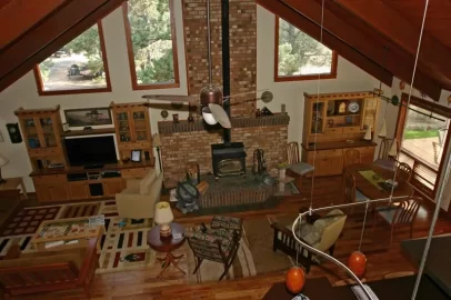

That's a very large and difficult house to expect to be able to heat effectively with one wood burning appliance in the Great Room...regardless of just where it's located, it probably ain't gonna happen. You could likely keep the Great Room & kitchen comfortable, and a bunch of heat will naturally find its way up into the loft...where it goes from there depends on the upstairs configuration. Ceiling fans are mandatory. Your Foyer & Study might feel a bit of warmth, especially with judicious use of fans. Your Master Suite, I'm afraid, will not benefit much, if at all, from the Great Room wood burner. The Pantry, Mud Room, Home Office, & Utility Room will feel next to nothing.
Traditional wood burning fireplaces throw away more heat than you can throw into them. Manufactured wood burning stoves and inserts are much more effective, but ya gotta realize they are space heaters. They generally do a terrific job heating the space they are in, but not so much the rest of the house (depending on the configuration & natural airflow). IMO, the home you've depicted here needs a ducted forced air central furnace system of one kind or another. I would most highly recommend that you look into a Natural Gas fired system, as you indicated you have that option available. Heating that whole house with wood is going to require either a wood furnace (to include ductwork, fans, etc.) or more than one wood burning appliance. In either case, we're talking about a major commitment to a heck of a lot of work & time involved to provide heat for this palace. A wood burning appliance can be a pure pleasure to own and operate and enjoy...but if you go into this expecting a bunch more than it can ever deliver, you'll just be frustrated & disappointed. In a house that big with that sort of layout, and jobs & kids & whatever to tend to...I'd put a good, modern, efficient forced air gas fired system in, then go from there for the fun stuff. A nice wood burning stove sitting at the end of the Great Room where you show the fireplace could be very nice, I'd say.
You haven't told us where you live...climate is a major variable affecting this subject. Welcome to the forums! Rick (Here's a pic of my place):
