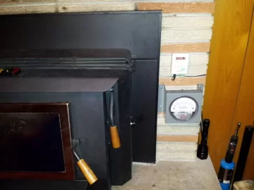

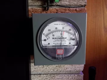

Over the last few weeks we have been averaging right about freezing, and it always runs about .10-.11 last night and tonight are going to be a lot colder. It was 8 out when i woke up this morning and it was running quite a bit more draft. Its pretty neat to see. The wind does have a pretty big effect, if its windy and gusty out the needle will jump all over like crazy. Its going to be 0 tomorrow morning, i'm curious to see what its pulling then.

What may I ask is this device?
Industrial vacuum gauge i hooked up as a draft gauge.
Reactions: Huntindog1
Well that's pretty neat NinjaTech.

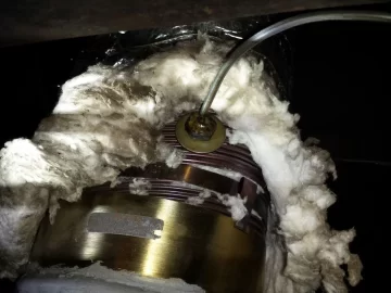

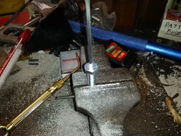

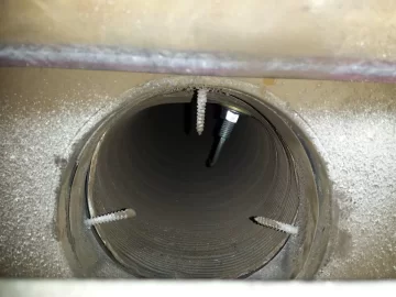

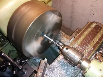

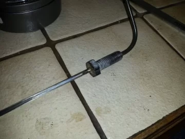

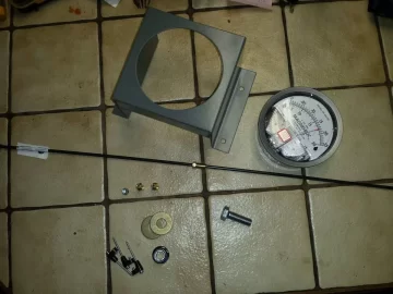

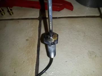

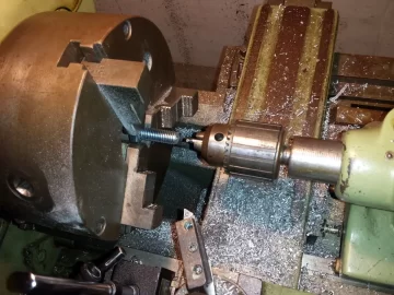

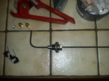

If your curious, here is some pictures of how its installed, you can find those gauges on ebay for a decent price. They are magnehelic vacuum gauges, for a wood stove you will want to look for one thats about 0-.25 inches of water. Its pretty much the most sensitive one they make, if you have a longer pipe you may want to go 0-.5 so you don't peak out a .25. (mine is about 14 feet) Here are some pictures of how i installed it though if anyone wants to do something similar. They are not really designed for wood stoves so you gotta kinda get creative in hooking it up.
