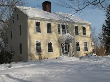

! I'm jealous you still have your 12 over 12 windows, are they original?
