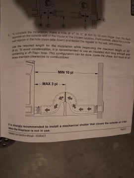

Potentially a draft reversal in the chimney could result in the oak becoming a chimney. When I installed mine it was very clear in the instructions to have a 'P' trap and the intake below the stove.

A p-trap is not normally specified for wood stoves that I have seen. It's more common for larger fireplace air intakes. In that case I think the P-trap is to trap incoming air so that the fireplace doesn't leak cold air when not burning. It may also act as a buffer to wind gusts?
I mentioned it because my Stratford 2 called for it, and a zc fireplace is basically just a stove enclosed in a metal case.

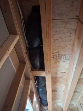

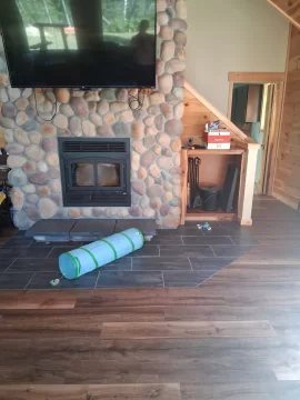

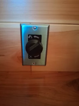

OP - On the fireplace the air intake is on the right side. The duct attaches, goes up, then down through the floor, attaches to the damper mechanism that's controlled by the wall mount, then out. The damper mechanism is above the 2x6 in the last photo.
