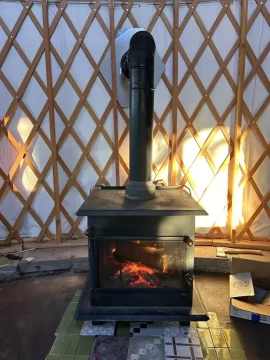

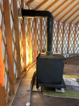

Hello,

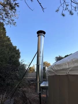

I recently setup an old stove I have in a yurt and am having issues with smoke blowback when I open the door. If I burn only very dry wood the problem is reduced, but still present and my burn is weak and temperamental. I open the door slowly, and try to keep closed until theres some heat in the stove. Unfortunately stove is choked 8” to 6” then pipe has a 3.5ft vertical (single), 4ft horozontal, then a6ft exterior run( triple). Do you think adding another section on external would improve draft?

The stove is getting choked down. It has an 8" flue collar goint to 6". Also, the hearth protection looks to be poor. With those short legs, there should be much better heat protection for the floor

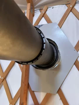

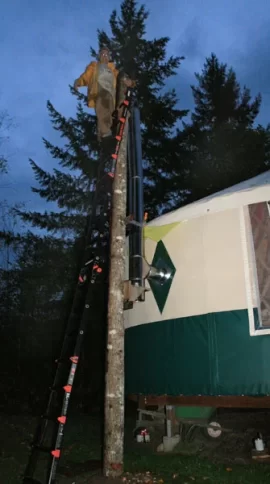

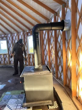

Besides the error of choking at the flue collar, there are a couple things wrong with the flue system. One, it's too short. It could use another 4 ft of chimney height. The second is the interior 90º elbow. The stove will draft better with a 45º offset off of the stove connecting to another at the thimble. Here's a yurt I helped setup years ago.

Thanks for the response begreen, and apologies for my delay. I added another section of external pipe for chimney, helped a little.

Thank you for the pictures. That log support looks great, and free! Can I use the 90' I already have and twist it down to a 45, or am I better of buying new? How did it end up pulling with that setup? I see a lot of yurt people setting up there stoves like mine with a 90, but they better stove setups than mine.
