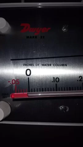

Ok Lcback, this is for you. Lots of pics of my cold startup with drafts. I have a 30 ft exterior stainless chimney. Hope the pics come in order. If not, it starts at +.01 then basement door open 2 inches. .00 starting fire with torch. 5 pieces 1x1x6 dimensional hardwood lumber. Ash pan open 1/4 inch. Small fire to warm things up, I like to start slow from stone cold. -.03 Then load some wood. After 1 minute -.055 bd damper doing its job. Lastly a pic for @brenndatomu of the conection.

Very cool. Thanks for the proof. Nice to know it happens no matter how tall your chimney. 30ft wow.
Maybe I will try a heat gun. A guy at work has one from harbor freight that he lights charcoal with. It ought to put out a lot of heat with no smoke before the wood lights.
What do you have the baro damper set for? I fooled around recently with my oil boiler and it recommends -.02" "over the fire" and -.04 at the breeching, although both my numbers were the same, so I left them at -.02. I don't recall what my pellet boiler is.
-.055 My unit calls for -.04 to -.06 recommends -.06
