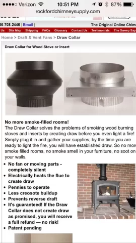

What about a draw collar?
(broken link removed to http://www.rockfordchimneysupply.com/rockford.php?item=DrawCollar)

Hello
They do not increase draft they only help to jump start draft that is hard to get going
