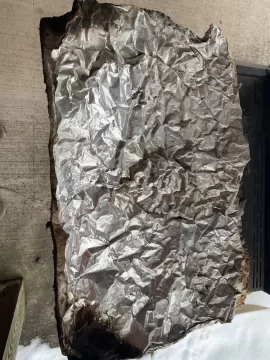

Here ya go. I don’t think I’m putting it back in.

That is not the right stuff. It looks like the metal foil is puckering making it not lie flat. Get some 1" kaowool (ceramic fiber) blanket material and trim to size.
Thanks. I ordered it today. I couldn’t figure out why things weren’t going good. It’s been a great stove and has been awesome in the past. I’m keeping my fingers crossed.
