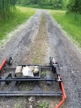

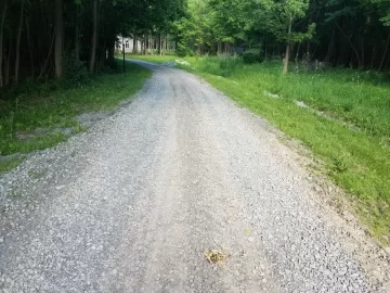

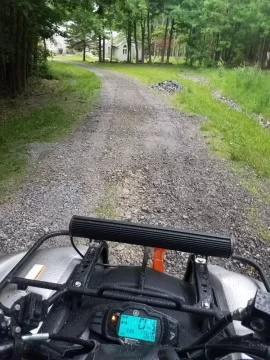

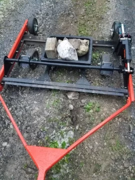

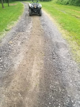

Well I bought a mint condition DR grader for $450 On Craigslist and put it to work. This is just after a few passes. I'm working the middle bump down and will go from there.
It is really tough going at first because it picks up all the big rocks. You have to stop and toss them or it slows progress. Follow up passes get faster and easier as you remove the big stuff.
Too late for pics after 10 passes.

Some other thoughts...
-This would be tough or impossible to use for a lawn tractor with my conditions. My 700cc atv that is 900lbs with me on it, lost traction and I had to use 4wd.
-It is working pretty well to fill ruts.
-1-3 mph is ideal so far. Faster would be possible without such rough conditions.
-good idea to use it after a light rain so there is zero dust.
- the power remote functions are not a gimmick..they work and save time.
-so far..i like it..more to come
That drag box is what I copied when I built my home brew of the DR grader. Mine didn't have a way to raise it. My driveway had a deeper, softer bed of modified gravel. I, like you was able to pull out the weeds and make it fresher looking. It does look like you could use a few loads gravel.
Cool. I have a bunch of loose gravel that has swept off the drive and I'm going to try and reclaim. We shall see.
I want as little gravel as possible since I'm always snowblowing and they don't like loose gravel. I'm more concerned it is flat without ruts for the winter.
It did come out nice. I now use the small pea size gravel, with stone dust. The surface is real firm. Much easier to snow blow on.
This was my first year snow blowing. I think one of my struggles with picking up rocks last season was that it was not flat, with ruts and a high bump in the center. That is pretty much gone now, so I think rock pickup will be much less.
