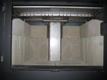

I have just purchased a new Baltic stove ( 1st gen. got a great deal ) I am wondering if the changes to the Baltic II like the new secondary air system and more firebrick makes that big of a difference to burn time or ability to heat ? is it worth adding another row of firebrick like in the Baltic II. I have always heard very good things about the Baltic 1st gen. is there any down side to the older version ? or is the 2nd gen. just all about the EPA ? any info on this would be very much appreciated.

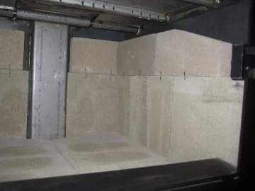

i continued to research the Baltic 1 and Baltic 2 as well as other secondary burn stoves like them and came to the conclusion that fire brick to the top of the fire box would be helpful to keep the temp up higher in the fire box and help get better secondary burn & easier. I went one row of brick higher by drilling each brick 1.5 inches deep and used 3 inch long, 3\16 stainless pins to tie the new top row together with the bottom row. they are all in there real nice and aren't going anywhere. I got the bricks free from a local wood stove dealer who had them but does not use them . nice guy. I will find out when it's burn time how well it works or not.

i also added a second row of bricks in my stove last season and was able to notice quite a difference. though i just stacked them on top without pinning them together. secondaries lit off a lot sooner with the second row of bricks imo

thanks for the feedback. i am glad to hear that this idea does work and makes a difference .I have not used the stove yet. it is brand new but, I thought to upgrade any way I can now and get good results from the get go. I wonder why the mfg. just didn't have a second row from the start , even on the older model. it's not a major expense in the build. once I get it all going next, I will work on getting some control on the secondary air supply. it made a real difference on my other stove. i'll wait and see how this new one does first.
