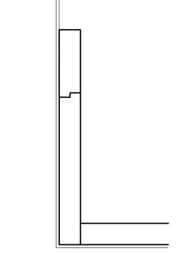

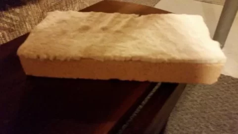

As far as the extra bricks go, I have recently tried two extra bricks on each side of as to not go farther back than that as it slightly retricts the
bypass damper from opening but the damper does almost open all the way if you do go farther back. I guess you could cut some bricks down or notch them.
I see a nice small increase in performance. But I think you can get the same using extra good dry seasoned wood like 18% moisture or less. But extra heat held in the firebox should improve emissions of the entire wood burn cycle as thats the main way these stoves meet emissions theory of operation. There is no way to put insulation on top of the manifold stainless baffle as there is no room to get up on top of the manifold. I am pretty sure the PE puts insulation in their stainless baffles. The insulation I used is ceramic 2300 degree.
[Hearth.com] Drolet Myriad/Austral Update [Hearth.com] Drolet Myriad/Austral Update [Hearth.com] Drolet Myriad/Austral Update
Thx for the info dog I'll have to give the extra firebricks a try. Not disappointed at all with the performance of the stove so far with this being my first full winter burning in it and first full year ever burning wood. When there's been issues, I know I can chaulk it up to subpar wood (too wet) and operator error. Only in the last month and a half or so have I become more confident in running the stove, mostly because of the knowledge I've gained here. Prior to that I relied too much on what a friend was telling me when it comes to wood and stove operation, and I'm pretty sure I probably over-fired her a few times last Feb. burning kiln dried scrap wood, so maybe that's why I see some warpage on the sides (seems permanent but the welds look fine and no top warpage). Had a cheap temp gauge, actually two from different manufacturers but they were reading much lower than the Condars I replaced them with this year (they're definitely worth the extra $). Yes, I've totally been bitten by the wood burning bug now that I'm starting to see good results like you and and the other knowledgable burners here see every day. So glad I stumbled across this place.;lol
