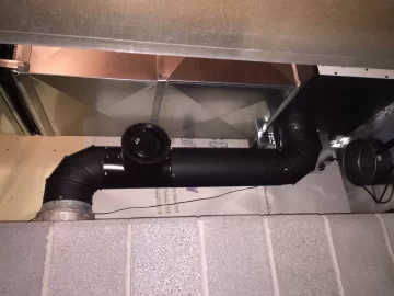

I've attached some photos of the install job.
Any ideas on what may be causing this "cool" burning?

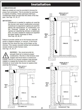

This is a pic from my manual regarding replacement air.

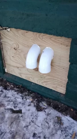

i used 4 inch pvc.

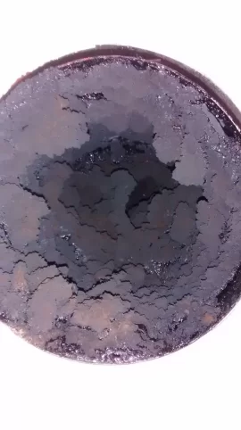

This was the smoke pipe from my furnace before I made these changes. It was almost 100% plugged after about 3-4 months of use. I just cleaned my furnace pipe and chimney a week or two ago and there was only just a small amount this time. Made a very big difference - all of the things I did.

When it's really windy out, it's incredible how much air the furnace pulls in from outside. You could literally blow dry your hair with how much air comes in. The purpose of the "J" trap on the bottom is to prevent air from just flowing in all of the time. It's supposed to only come in the basement as the furnace needs it.

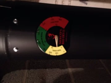

Well I changed my chimney pipe around, removed an unnessary 90 degree elbow, have a raging fire going, with air inlet damper open, and cannot get flue temp to rise above 100 degrees???

Your not going to see 400° on the outside of the exhaust. You might see 300° with an open damper with a large load, but usually 250° or so with a high fire and 150° to 200° external when in cruizing mode. What size and type is your chimney, and what's the height?

6.Those external magnetic thermometers are notoriously inaccurate.

+1 on inaccurate magnetic thermometers.
I have one right beside my probe. When I'm burning, the magnetic reads a full 100c less than the probe.
