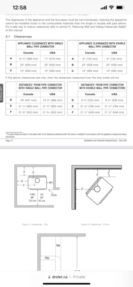

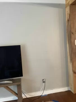

Looking to place new stove in this space. We will be building a brick hearth & brick wall behind the stove. We would like to put the stove next to this wooden beam- looking at measurements I’m confused with our double walled pipe what the closest to the wooden beam we could get.
Based on the info I’ve provided from the manual, it looks like 48 inches or closer to 22? Am I way off?
Thanks!!!

Looks like 22" is the minimum side clearance. This stove will be replaced next spring with the Deco II which has a side clearance of 15".
