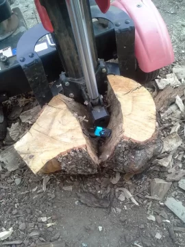

I just picked up on a scrounge, some old dead Red Oak, no bark , punky on the outside ,primo and solid inside.

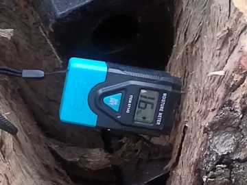

I don't know how old this stuff is but , I busted a couple of rounds open , one ,19" X 20" long , checked it 20 different places and ,WOW , 17 to 22% MC .:)
Hard to believe that big of a round is that dry inside, but it is .
The other one I cracked open was 22 to 30%
By the looks of it the smaller stuff 6,8,10 in may be ready to burn , more checking and ,we will see

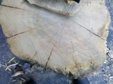

Here is mine. 2ft across, 12 inch long round cut last September, so I was told. Blue oak. This was hard to split with the hydraulic. The whole load was similar in several MM checks throughout, I collected it earlier this year.This was to be a part of 2-3 years down the road wood, it is ready now! I probably don't need as much lead time for seasoning as I thought. Something I will be monitoring from here on out.

Yeah, my oak looks like the ones in HDrock's photo. Now, my meter says it's around 20+-%, and it beeps fast with 3 drops showing, indicating wet wood. I wonder if the thing lies? Also, please refresh my memory; dry wood is what moisture content? I have 15%- in my mind.

UPDATE- that oak seems to burn pretty good. I split it and left it sitting on the driveway in the sun. It's only been a few weeks, but it burns nice. Doesn't even seem to sizzle at all. It was a complete groan to split by hand, though. Tough as nails. So mow I'm thinking that my moisture meter reads high. 20% or so on the meter is actually drier than that.
HDRock, I see you have a HF 7 ton electric splitter. How does that work? Does it do any knotty knarly stuff at all?

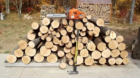

I live in an area that was hit many years ago by some Oak tree killing disease. The woods around my house are littered with all the dead, dry Oak I could ever gather. The disease didn't kill them all, but there sure are a lot of 6" to 10" diameter, dead, standing and downed trees. All of it bark-less and dry! My HF meter shows 8 to 18%.
This was a few hours work. most everything there is 48" long. There are a few 16" and 32" in there too.
It does a surprisingly good job with knotty knarly stuff, sometimes you have to reposition it a couple of times , I have sliced through 3" internal knots.
