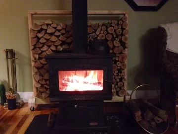

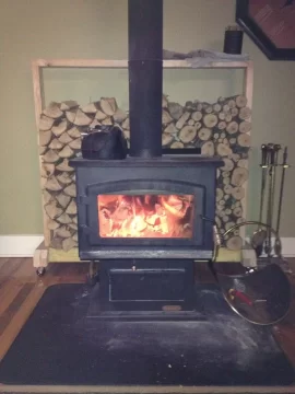

I usually stack some fresh cut wood on my rack to add humidity to the house. Save the wood for emergency only. Here is a photo from December 30 and a photo from yesterday. The wood has settled 3". I did remove two pieces and have not checked for moisture content.

Blazincajun...clearances to combustibles?? Looks iffy.
Yes it's close - 8" behind shield and 12" from pipe. Wood is cut short at 10". If for some reason it falls I would be in trouble. Maybe time to switch it out for more green stuff. Thanks for the reminder.

Meinn Gott, is that wood rack on casters?? How brilliant. I keep mine stacked under the carport and can only sweep when empty. Oh my god, and that would solve that pesky LIFO problem that always occurs. I am really glad I saw that!!
