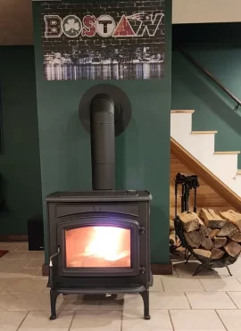

So has anyone took the temperature of the wall behind their stove and the the stove pipe? I went with the minimum clearance plus like a inch or two the my drywall is getting pretty hot to the touch. I think I should cut it out and add an air gap and screw some 1/2 cement board. I have regular 2×4 studs and rock wool insulation behind the stove. Should I remove the insulation and let the wall breathe more? I'm running double wall pipe and took all the precautions

Define pretty hot. Can you hold your hand on it briefly? If so, how long. a micro second, one second, three seconds?

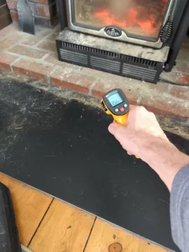

I don't have a free stander but I do have a powdered steel hearth extender that gets quite hot, around 150 to 180 degrees, which is too hot for my liking. I added Micore underneath it to protect the hardwood floors. Those temps aren't going to damage the wood right away but exposure to those temps over time pyrolysis becomes a risk. Now the floor gets no hotter than 120 degrees which is perfectly safe.

It's hot! 160 on the infrared, behind the pipe even more
That's about the limit of my comfort zone. Our Castine gave similar readings even though the clearances were exceeded by several inches. It was a highly radiant stove. The corner install walls were hottest around stovetop level and maybe higher, Now, with the convective T6 in place, there is no issue, even though it's much larger.
Woodsplitter, what stove is installed?

So I was on a hot reload when I took the readings. Still trying to dail the new f55 in. I even installed a damper in the pipe right before the thimble. Even closed down it will cruise at 800 to 900 exhaust themp about 700 on stove top. Yeah it was pushing 200 behind pipe on the sheetrock a lot more than I'd like to admit

200º on drywall is too hot. The stove is running hot. Try loading it tighter with large splits and smaller splits filling in the gaps. Also, close down the air sooner. This should slow down the burn and bring the temps down a little.
What is the stove connected to, a masonry chimney or stainless liner? How tall?

First of all, congrats on the new stove and on having dry wood. That's a good start. The 8" interior flue is moving a larger volume of air which is creating a strong draft. A key damper will help tame this if the changing of operation does not achieve the desired result.
Is there a rear heatshield on the back of the stove? How are the temps being read? If using an IR thermometer, make sure it's in calibration. If the changes don't bring down the wall temperature to a more reasonable level, say 140º, then putting up a wall shield with a 1" gap behind it will make a major difference. This doesn't need to be cement board. It can be just a sheet of metal that can be painted, or even fancy made out of copper sheeting or the like.

Try putting up a heat shield. There should be 1" minimum air gap behind the non combustible shield. The shield should have a 6" or so gap on the bottom (installed higher than the floor) and it shouldn't go as high as the ceiling.

Yes, the shield would need to be on 1" non-combustible spacers. It can start at least 1" from the floor and reach to about a foot over the stovetop. It can go up the full length of the wall but must be open at least 1" at the top. This is to allow cool air to convect freely behind the shield.
