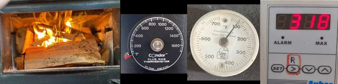

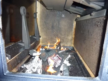

Questions about starting a fire and avoiding a runaway stove come up so frequently I decided to document starting our stove. This is a Pacific Energy Alderlea T6 with about a 3 cu ft firebox. The stove is connected to a straight-up, 20' interior flue. The outside ambient temperature is 34ºF. The blower was off all the time for these shots. The firewood is douglas fir at about 17% moisture content. This is a N/S loading. An E/W loading start will follow.
NOTE: as testing will show, the older Condar flue thermometer is reading low. It needs recalibration.
There are 3 instruments shown.
  1. A Condar probe thermometer on the double-wall stove pipe for flue temperature.
  2. The stovetop temperature on a Sandhill thermometer
  3. A digital probe readout in the stove pipe for the flue temperature using an Auber AT100

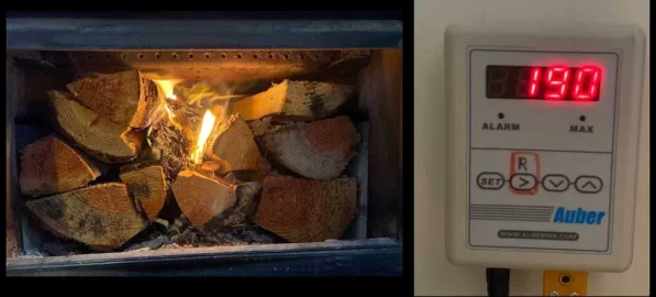

Here is the stove loaded with a gap in the middle for a top-down start. 3 balls of newspaper and a few flakes of kindling on top.
[Hearth.com] Starting a fire and running an EPA stove

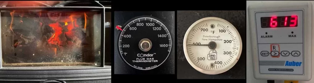

Fire started, flue temp and stove top temp is <100ºF. Door left open about 1/2".

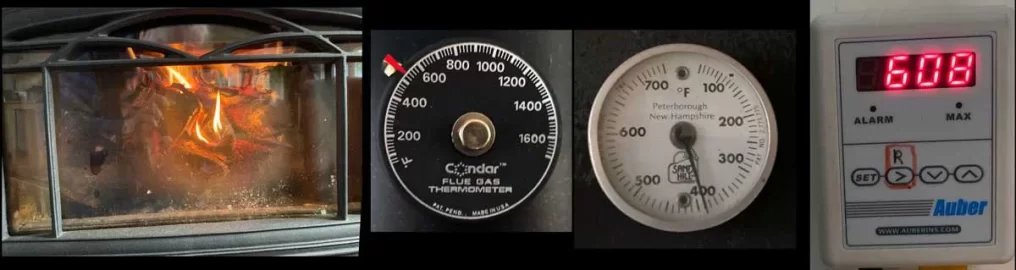

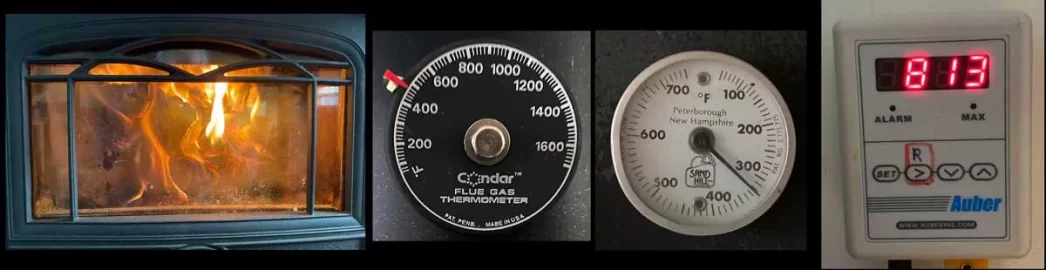

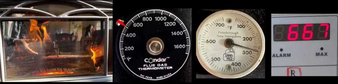

Time to insert a split into the gap then close the door, with the air control wide open. This picture is showing the stove, the Condar, the stove top, and the Auber.

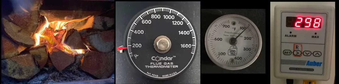

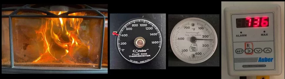

Dry doug fir takes off quickly. This is about 5 minutes later, time to reduce the air to 50%. There will be no creosote worry here even though the stove top temperature is still low.
Just a few minutes later and secondary burn is getting robust. Reduce air to about 70% closed. Note how stove top temp is still low and the probe flue thermometer is lagging far behind the digital probe. The digital probe reacts almost instantly.

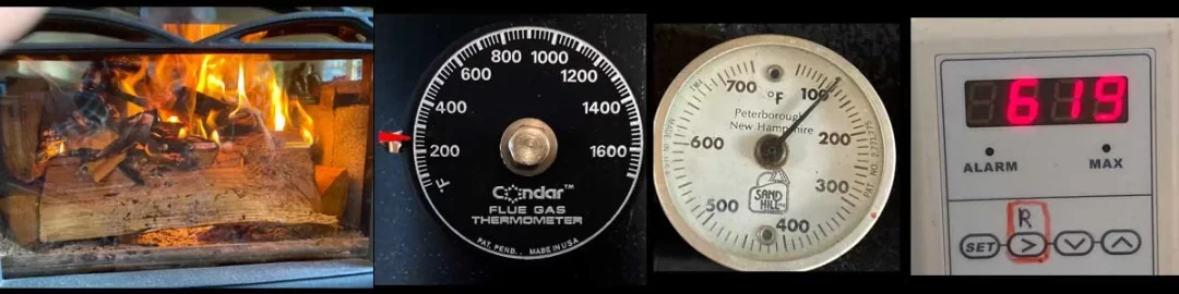

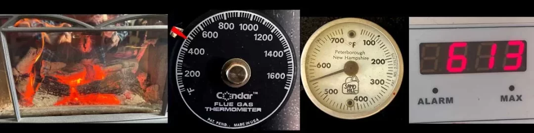

After another 5 minutes the fire is going strong, tme to close down air almost all the way, maybe 85% closed. If it was 10º colder outside I would be closing the air all the way due to increased draft. Note the stove top temperature. It's catching up but not fully warmed up yet. This is why stove top temp is not as helpful in a cold start. It takes time to heat up the mass of the stove, while the flue temp is already very high. Unfortunately, the Condar flue probe is sluggish which is less helpful, but combined with the visual cue from the firebox it's obvious that the air needs to be closed down until the flames slow down.

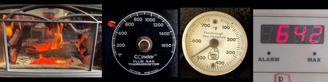

Just a few minutes later the fire settles down. Secondary combustion is now robust. No need to change anything. The stove top temp still coming up.

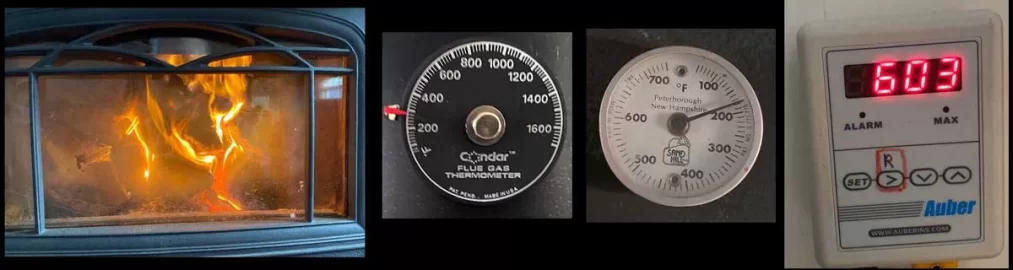

The stove has been cruising for 20 minutes and is almost up to temperature. The stove top settled at 625º. The analog probe thermometer is finally catching up to the digital probe.
Note that this is just one example of a N/S load of softwood in a large stove. There are many variations. This load of wood has a lot of young growth and sapwood in it so it is not as dense as old growth doug fir and it burns quicker with less heat. Every fire will have a somewhat unique character depending on firebox size, how much fuel is loaded, how tightly it is packed, outside temperature, and mostly, the operator. If you don't have thermometers, consider one, at least for the flue temp. And use your eyes for visual cues about the stage of the burn.

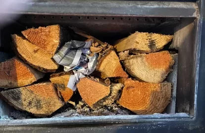

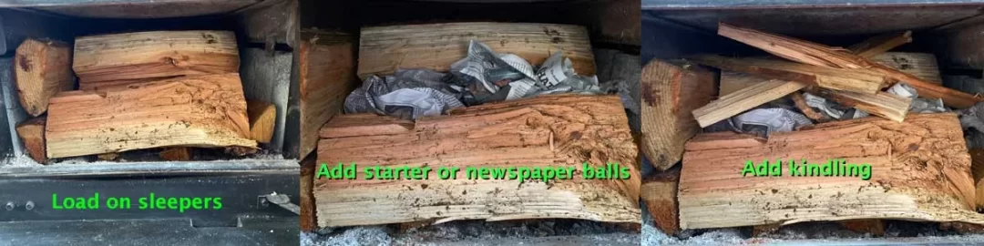

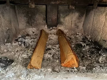

Ok, I let the fire die down last night so that I could do an E/W cold start this morning. Note that the T6 has a deep firebox, so I have more wiggle room than some with a shallower firebox, but the general principle is the same. To start with I laid down 2 sleepers about 6" apart on which to lay the E/W splits on. This allows air to get under the wood to assist the fire. Without them, the start would be slower. If there is a hot coal bed then this is not necessary.

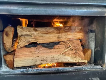

Then splits were put on top of the sleepers with one large split in the front to act as a base. The loading needs to be biased toward the rear of the stove so that splits can't roll forward. This means that the wider edge of forward so that the wedge shape of the split is toward the rear. The rear is stacked higher and a pocket has been left to accommodate newspaper balls and kindling to start the fire. Then kindling is stacked on top of the newspaper balls (or starter).

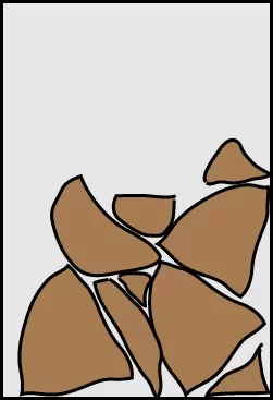

This is a sketch of a hypothetical load set up so that the splits won't roll to the rear of the firebox. There is a trough on top for starting with paper (or starter) and kindling. Once the fire is burning vigorously, another split can be placed on top if needed.
Side View:
front of firebox [Hearth.com] Starting a fire and running an EPA stove rear wall of firebox
The newspaper is ignited and the kindling starts burning. At this point the door is slightly ajar to admit more air and of course the air control is wide open.
Reactions: Graphite
The kindling fire is now burning robustly. Time to latch the stove door closed.
Reactions: Graphite
A split is added on the burning kindling to fill the gap, but not smothering the fire. Note that the fire is now also burning under the logs between and including the sleepers.
