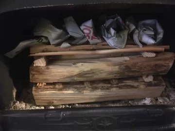

Basically, my load w/paper and kindling looks identical to the photo @begreen posted at the start of the thread, then after lighting:
1) I leave the door cracked until my Condar flue probe reaches ~400F, then latch door. This is less than 5 minutes.
2) Continue to burn w/thermostat on high until cat probe is at or approaching active zone, then close bypass, maybe 15-20 minutes after lighting. My flue temps typically will not go over 700-800 with bypass open, but in a couple cases I've skipped to step 4 before closing bypass.
3) Continue to burn on high w/bypass closed until I get within a few degrees of desired room temperature - typically not more than 30 minutes from lighting but it can vary. For my installation the flue temp will top out at 600-700 degrees while on high w/bypass closed.
4) First turndown is partial, approximately halfway between high and cruise settings, for maybe 10 minutes or so, depending on how forgetful I am.
5) Final turndown = happy cruising!
This is for the BK Ashford 30 cat stove. Hopefully this helps.

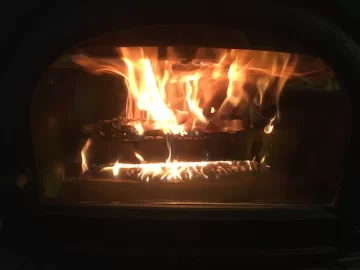

5:15 PM - Top down start using 5 splits, 2 'half' splits, 4 balled up paper towels and some kindling. 35F outside temp, 70F inside:
[Hearth.com] Starting a fire and running an EPA stove
5:22 PM - Condor flue probe is @400F, latch door.
5:27 PM - Flue probe @600F.
5:38 PM - Engage CAT, flue is oscillating 550-600F with thermostat still on high (6:00 on the dial).

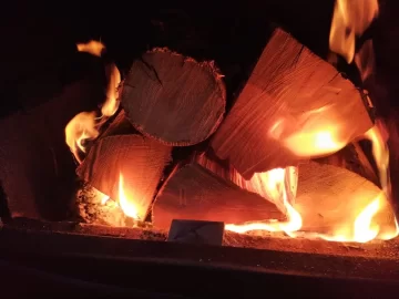

8:40 AM - Flue is back up to 400F. Very little smoke from chimney:
[Hearth.com] Starting a fire and running an EPA stove [Hearth.com] Starting a fire and running an EPA stove
8:55 AM - Flue is at 550F, CAT @12:00. Turn thermostat down to med-high (4.5 or 4:30 on the dial).

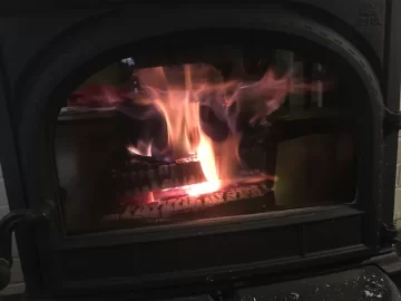

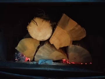

Thank you, begreen, for this excellent information. I have a Jotul F400 Castine (which is all E/W loading) and have completely switched to top-down fires. What made all the difference in getting the load ignited relatively quickly was to insert thin sleepers (spacers) between each layer. This is something I learned from a related thread, where a member named Pen emphasized that the splits "need air between them vertically but need to be very close together horizontally." Without the sleepers, it took forever for the bottom splits to catch. Now, with the sleepers in place, I have a roaring fire in no time, pretty much as fast as when doing a bottom-up.

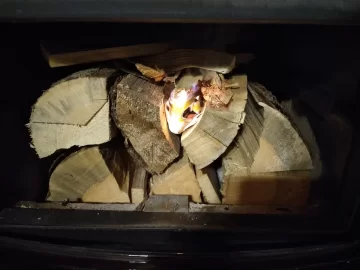

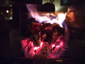

But in contrast with what you do, begreen, I build a stack of three layers: three bigger splits at the bottom, smaller splits in the middle, kindling and then newspaper on top, with each layer separated by a thin sleeper (a half-length piece of kindling).

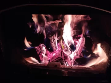

15 minutes after lighting:

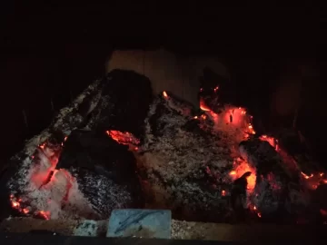

After about 25 minutes, cruising at 550 degrees or so:

But now I'm curious about begreen's method of nestling the newspaper and kindling between the front and back logs. I'll try it next time.

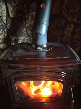

I also have a Jotul f400 Castine like pdxwoodlover. I just made a short vid to show what lighting my top down looks like at start up. I love it and am a convert from the old school bottom lighting technique. Hope this can help someone. This has been a great website packed with super helpful people. Thank you.
Youtube vid: Using 1 fatwood piece, sticks and oak splits seasoned 1 year.
Looks great. The Castine starts secondary combustion pretty quickly. I started out going by stovetop temp for closing the air down but found that it took a long time for the thick stovetop to warm up. Meanwhile, the fire was showing me that it was time to start closing down the air. This could be with a 250º stovetop on a cold start.
