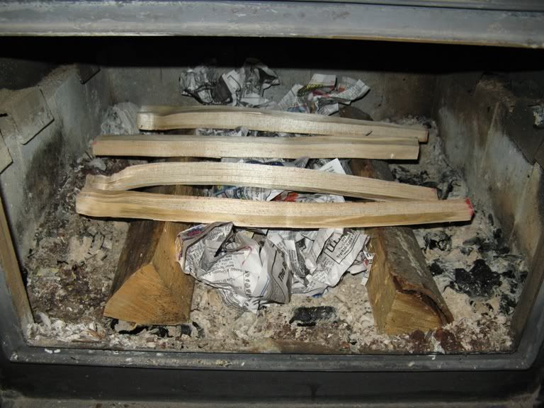

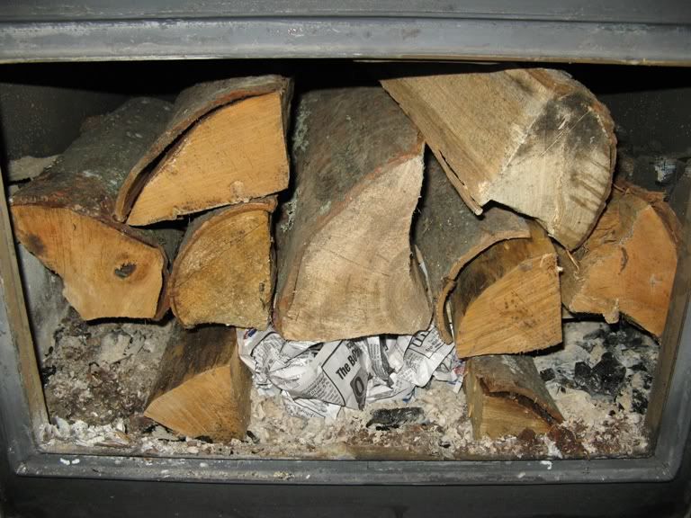

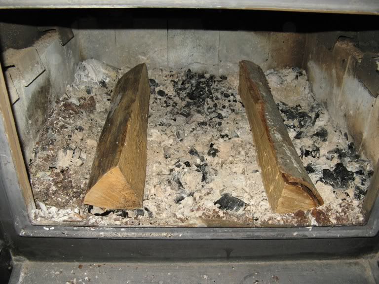

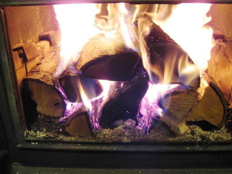

The time it took from the first to last picture was less than 20 mins.

I think you are expecting something spectacular to happen, and it just ain't there to happen. The main thing about a top-down fire is that, if done correctly, you get a good fire every time, and it burns cleanly from the beginning. With your experience, you are probably already getting those results with a conventional startup, but like you say, it is an acquired skill. New burners can often get better results using the top-down method.
Personally, I've tried it for numerous outdoor fires last year and I have had great results. Naturally, I couldn't wait to try it in the stove. Results there were mediocre at best. It works, but I find I get the stove a lot hotter a lot faster by using my tried-and-true method graduated feed method, kickstarted by a wax/sawdust firestarter like the Super Cedars. I recently timed a cold start (stove at about 125ºF, flue at 75ºF) and found I can go from cold stove to 700ºF in less than 20 minutes.
Here are the stove top temps as they climbed:
10:00:38 - 350ºF - 8 minutes and 27 seconds after lighting
10:03:17 - 525ºF - 11 minutes and 8 seconds after lighting
10:05:40 - 600ºF - 13 minutes and 23 seconds after lighting
10:09:00 - 700ºF - 16 minutes and 51 seconds after lighting
I don't know if anyone can get their stove that hot that fast using the top down method, but I know I can't even come close. I'll stick to the conventional method in the stove while experimenting more with the top-down method when camping. The sweet thing about the top-down for a campfire is that you get a completely even coal bed for cooking in under half an hour. When you're done cooking, just pull the coals together in a pile, toss a few splits on top and your evening fire is instantly underway.

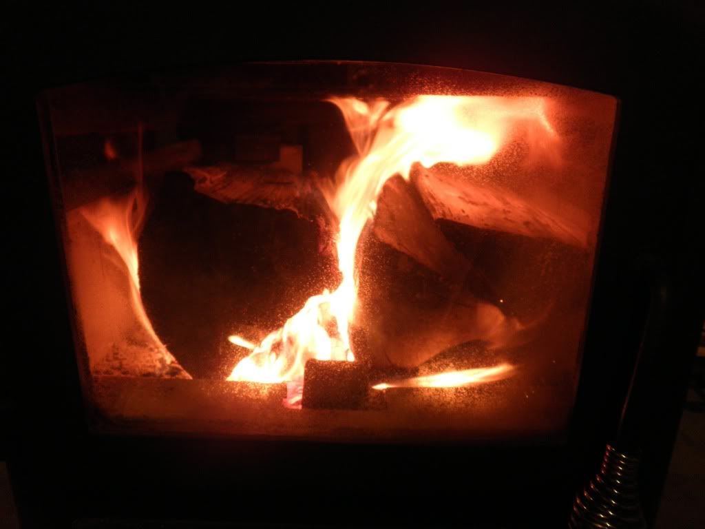

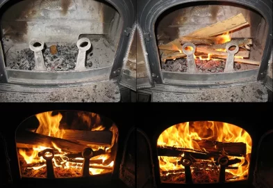

Here's the photo sequence of the beginning of the conventional startup I mentioned, along with the times involved.
First photo is time stamped at 9:52:09, just prior to lighting the starter.
Second shot was taken at 9:55:44, 3 minutes and 33 seconds later. I added more wood at this point and closed the doors.
Third shot was at 9:57:05, 1 minute and 21 seconds after the wood addition. Closed the doors again.
Fourth shot was at 9:58:41, 1 minute and 36 seconds later. I closed the doors, shut the intake damper to about 1/4 open, and waited while the temps rose.
So, from firestarter sitting on top of mostly charcoal to the last photo with a box full of flame - 6 minutes, 30 seconds. This was with less than "ideal" wood as well, up close to 30% water. Note.... not a lick of smoke at all at any time. ;-)

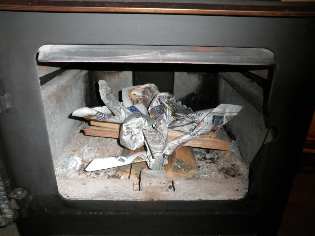

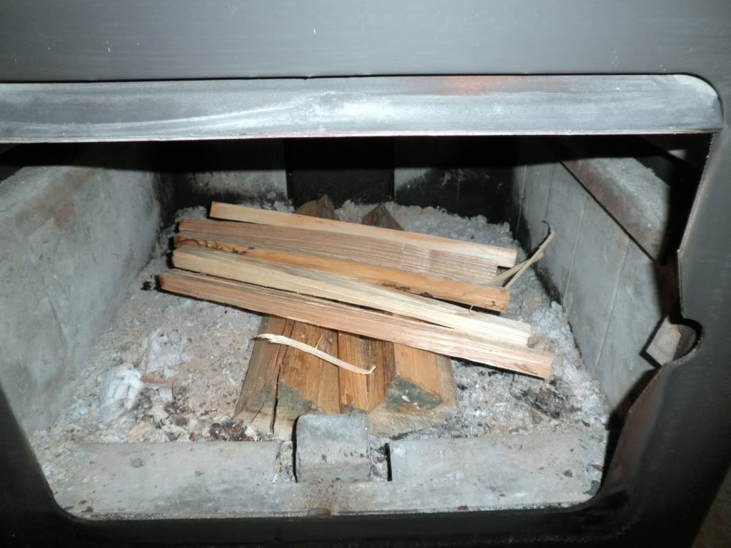

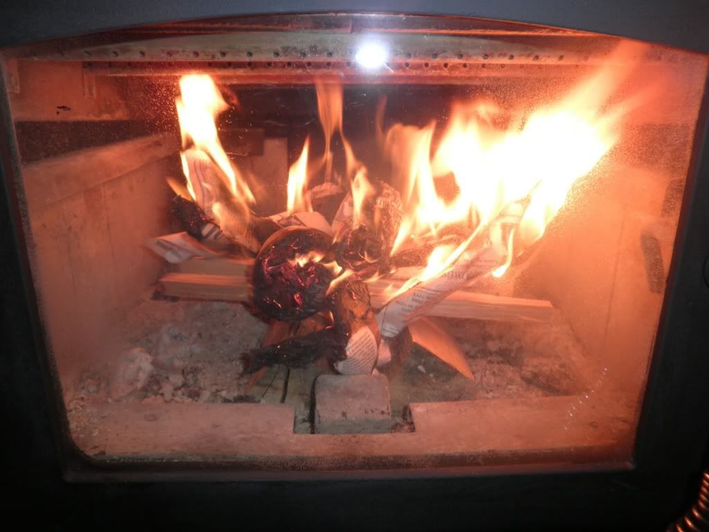

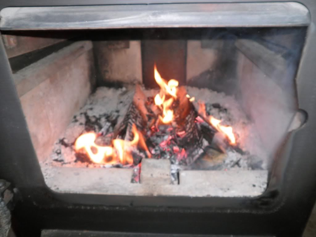

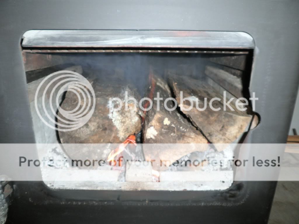

With my old pre-epa fisher here is how I started the fire
[Hearth.com] Top-Down Fire Laying: What Am I Missing Here?
The top down method wouldn't work for beans in my fisher because of how the air entered the stove. So much came rushing in past the dampers that it would basically put out any fire on top of what I was trying to start. If I tried building it up higher in the firebox, then the air never hit what I wanted to burn.
Now, when I purchased my englander stove I tried my old starting method and it worked, but I had to babysit the stove more as I needed to leave the door cracked, come back in a few minutes and close the door, come back and adjust the air. With the top down method, I can start the fire without leaving the door cracked. Additionally, I have neighbors that are only about 40 feet from my chimney. They have never complained but I do what I can to keep my fires as clean as possible so that it doesn't bother them. With the bottom up method, there is always some smoke. With the top down, there is virtually none.
I really need to re-do those top down pics of mine and put some better ones up.
At the end of the day, use whatever works for you. The goal is the same. Perhaps try a modified method? Every stove will be different. Especially if you are comparing a non-epa to an epa stove. Those are 2 different beasts.
Now that I have some practice, I can guarantee I can get this stove up to temp using less kindling and in less time than I used to be able to using my old method. This is especially true if the firebox has no or very little ash in it.
