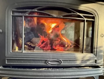

Question for begreen, please! I’ve watched these vids off/on over the past warm season, and refreshed my study with my first burn this week. I cannot tell where you are placing that stove top thermometer. Last season, you remarked that you were surprised I could get 600 degrees from just 3 pieces of hardwood. It occurred to me this summer, that perhaps your thermometer was placed on top of the grill, rather than below the grill - directly on top of the firebox.
So I now have 2 thermometers. One is directly on the firebox underneath the grill. The other is close to it, but on top of the grill. The lower one reads 750 while the one on the grill is not quite 350. That is with 3 small pieces of red oak and 1smaller piece of pine, from a cold start.
When the thermometer on the grill reads 400-500 it warms the room up nicely and burns much longer than when it reads 600 on top the firebox. I’ve been afraid to try loading it up and doing the top down burn for fear of (you got it!) a runaway stove! Thanks for explaining how that burns less hot! I understand the concept but not ready to try that just yet.

Well dang! That means I’m back to just burning 3 small logs and keeping close watch. Is there a safe way to remove an actively burning log? I want to try adding more logs, but shutting the airflow down sooner. When it gets too hot, I have lowered the temp by separating the 3 logs further apart, but won’t be able to do that with additional logs.
Twice the stove got too hot - according to both thermometers! I used a fan on a stand to blow the heat away and it brought the temp down fairly quickly. But that would only affect the external temp, not internal so I don’t want to rely on it.
Again, thanks for your time! I’ve gotten no help from the installer.
Loose logs with burn faster because of all the exposed surfaces. A tightly packed mass of wood burns slower.

I’ve been experimenting….. found the boost air hole and covered it with metal tape. That alone helped keep things in check somewhat. Was able to get a nice burn with the usual 3 small splits without it getting over 700 STT.
Then used larger logs, packed together. The first time I let it go too long before closing the air down and the STT got to 750. Since then I literally sit in front of it doing something useful for 60 min….. keeping an eye on it has kept the STT from going higher than about 725, then it comes down and cruises around 600 for 2 hrs.
Having repairs done here prevented me from being able to stay in the house so I haven’t been able to do more than one small burn in the last 2 days. Hoping to continually improve my handling. Thanks again everyone! What a blessing y’all are!

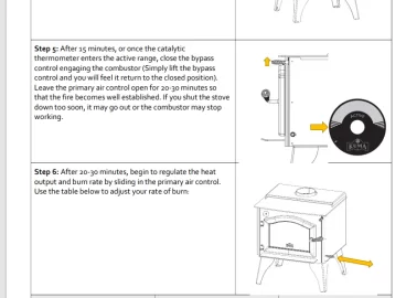

This thread had me curious so I looked at the suggested operation of my Kuma. They call for 20 mins on full air after engaging the catalyst. I feel like that's a good way to toast a cat pretty quick. I typically go full air until my Condar probe reads 400-500, engage cat, full air for 5 mins or so then pretty aggressively cut it back down from there. I have good performance but I am still mulling over a flue damper to get some increased residence time as I struggle with smoke out of my flue even with everything else looking great in terms of temps, chimney cleanliness and fuel.

This is EXACTLY how I would light a fire with my previous stove, which I had for 30 years. It does not work AT ALL for my new Hearthstone Heritage with a catalytic combustor. I have to build a fire with lots of spaces between the kindling, and lots of newsprint. Thanks for this, though.
Some stoves need more draft than others to get started, though the bypass should make this easier in the Heritage. I am mostly doing top-down starts with nice dry and loose kindling. You might want to try a starter like SuperCedars. A quarter slice will get a fire going easily.
