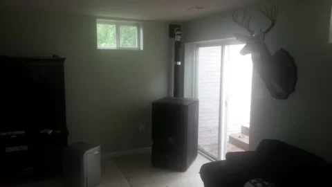

Here is the scenerio. My stove is in the corner of my basement (finished area directly under my family room). My house is a 2 level (not including basement) approximately 2600 square feet for the first and second floor total. I would like to run the duct directly up above the stove. Only one duct run and leave the second open to heat basement. This would put the register on the floor of the family room. The duct would go through a drywall ceiling in basement in between 12 inch trusses and terminate on burber carpet of the family room. My main concern is the termination into the carpet and through the basement ceiling/family room floor. I dont want to worry about the temperatures coming through the duct. The distance from the plenum to the temination will be approx 5 feet.

Can u post a few Pics? That would help.
I ducted half of my stove to the living room and kitchen above. Used the stairwell for the cold air return and mouted a fan in the doorway to the basement. What r u using for the return air?
Sorry for the delay in the response. Here is a pic. I plan on ducting straight up. The duct would go through the ceiling to the side of the other return you see on the ceiling. I have 16 inch trusses the duct would pass through and then terminate into my living room which is carpet.
the stairwell will serve as the cold air return.

Looks good. Question? What is the point of the plenum? It says a 15 inch minimun is required. Is this box to cool down the air before it enters the duct?
The biggest concern I have is that the duct does not get to hot going through the ceiling when it is contact with wood and carpet.
I'm no expert in plenum but I imagine that it is to create a certain volume of air before it goes to the duct which also cool it down.
By using some floor boot that your duct will be connected to, your duct is not really in contact directly with the floor.
From what I have seen so far, it gets warm but not overly hot, not worst than oil furnace duct.
Cheers..
Good answer. That makes sense. To build up enough air to move before its gets to the duct .Thanks again!
