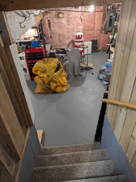

That's a really good idea. Let me show you.
These photos show the staircase down into the basement where the stove will be, and the opposite view looking up. Then a shot of the 2nd lower level, the rec room. And the staircase going up into the main level.

Hmm feels pretty tight and like the airflow thru the basement up to the other levels will be fairly restrictive?
Where is the existing chimney?
Out through the foundation on the far right side of the house.
It's a little tight here yeah, not much wasted space

So is that the chimney straight across from the stairs?
About 4-5 ft up the wall between the studs with some yellow insulation stuffed in it?
Yeah that's it.
I suspect the previous owners had left that section of wall uninsulated when they had their own stove there (there was an 80s or 90s Chaleur stove down there disconnected when we bought the house). Then it was framed up and insulated.
The chimney on the outside looks brand new, I'm hoping it held up ok.
