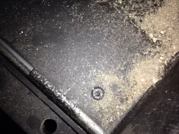

I too thought the were torx head screws but looked again and decided no. Not being an expert on any sort of screw I had hubby look and he said they appear to be rivets.
[Hearth.com] Dumb Question M55 Insert Screws on top sheet metal

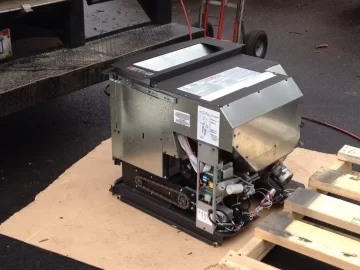

That does look like a rivet, maybe it was the back vertical panel panel. here is a pick of the back of mine, it looks like screw heads
  • [Hearth.com] Dumb Question M55 Insert
Yes, the back panel has regular screw heads. The top sheet metal are definitely rivets though. Nothing like making life difficult!
