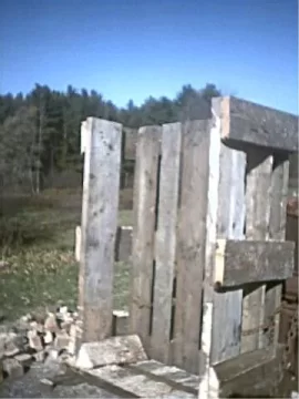

Having 6 cords of split wood to shorten for a different stove, I built the little firewood chop saw shown elsewhere in this forum. Someone in another forum said it would do the trick but would be slow and why didn't I build an oversize sawbuck to cut a bunch at once. I said yes that would be faster sawing, but extra stacking and loading would be involved that way, because after sawing I throw them in the loader bucket and dump them right on the porch. But that got me to thinking and here's what I came up with;

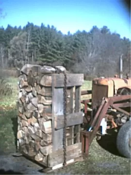

A crib made out of an old pallet chained on the loader forks where I can stack them out of the pile, saw about 1/3 cord at a time and dump them on the porch.

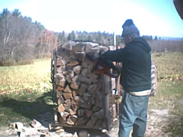

My bar is 18" so I made it 34" wide so by cutting from both sides, I go all the way through.
The guide boards are an inch short of the length I need..
After loading I just throw a chain and binder around it to hold everything tight and a couple minutes sawing on each side and it's ready for the porch.
This rig could be adapted to any loader or redesigned for 3 pt hitch.

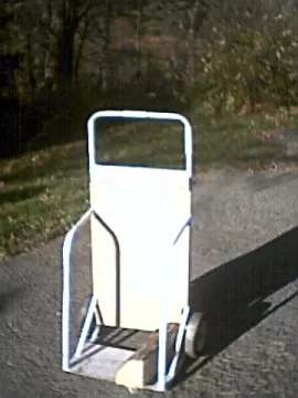

I suppose if you don't have a tractor, You could even do it to my little wood cart.
Smiley
Unfortunatly, I don't know why, but the photos don't seem to go through correctly on this site.

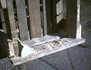

Just don't forget them forks are sitting on the bottom of that cage! Great ingenuity, Keep the tips coming!
Got that covered hardwood. I left that bottom 2x8 sticking out past the cut, so I get pine before steel.
