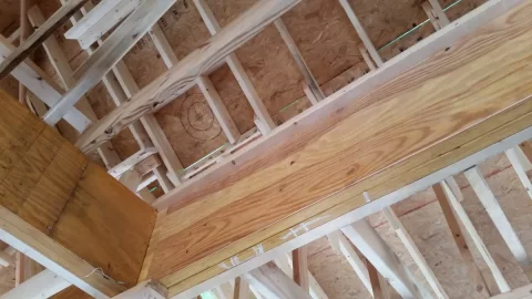

Here are a few pics to clarify things.

no problem there at all. i would put a 2x4 across the flashing and pound it to get a really nice fit along that transition, but it is on the bottom end and pretty minimal. at first i was envisioning the bend being in the middle of the stove pipe!

Pics are worth a thousand words. Yea, a transition in the middle of the pipe would be a problem.

Were me I wouldnt nail or screw the bottom edge in this case. I would nail the sides and let the bottom couple of inches bend just from the force. Cant be sure until you do it how it will work best and land on the shingles. Moving it a foot up the roof would be better but cant always do that I know.
That makes sense to me about not nailing it. Right before they lay shingles, I plan to cut the hole and attach the flashing with the top holes only. I'll let them do the bottom since they will provide a warranty.

Maybe it could use a few more inches wall clearance and would move the whole flashing up the roof some so no transition? It
looks awefully close to the support beams/members from your one picture as far as stove piping goes.

Going with a BK Sirocco 30. I'm doing a corner install and positioning the flue 19" from each wall (~1" over minimum). There is a lot more clearance than it looks. Not sure if this pic helps, but heres another view.

Looks like it will work fine from that angle.
Ok, our roofer wasn't comfortable placing the flashing that close to the valley. I have purchased a 15 degree offset kit to shift the chimney up the roof about 8 inches. I also bought a 12", 18" and 24" piece of Duratech to play with in order to get the desired offset. It seems to me that a standard brush should work just fine, hopefully it will.
