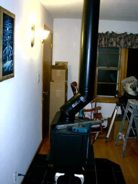

I am not an expert but this is my understanding, you can not have a 45* in chimney( duratec), but is is OK to have a 45* or a 90* in the stove pipe(DVL). Your situation sounds similar to mine, I installed 2 45* to offset my stove closer to the wall. Here is a pic of my installation.
  • [Hearth.com] Duratech Elbows & Other Chimney Install Headaches
Thanks for the quick response. That image is similar to what I would like to do. I have come to the same conclusion as well about the 45's being installed on the interior pipe but haven't had anyone knowledgeable verify that notion yet. Did you have your install inspected by a certified chimney tech.?
Great - thanks a million! I appreciate the clarification and will wiggle my stove back to where I originally wanted.
