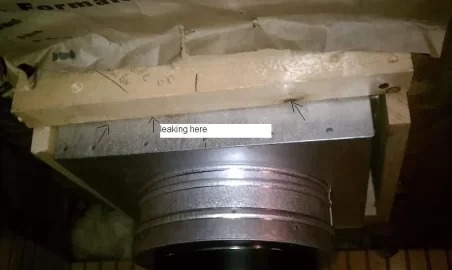

k here is where its leaking inside

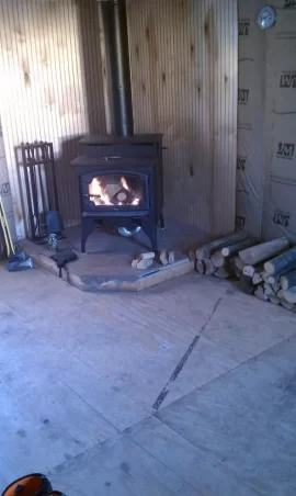

here is the new endeavor with air kit that the leak keeps dripping on and pissing me off !

Is it possible to see leak under the roof flashing from the interior side? Also, can you post a picture of the outdoor flashing? I'm wondering if your high winds have broken the seal around the storm collar. Did you get the second brace installed yet?

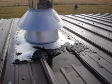

ok here is my flashing job , shody i know , but i have no clue how to do that on a metal roof , i know crap is gobbed all over , my main purpose was to make it not leak , pretty was not of my concern.
now by seeing the water puddle there you can see the leak isn't comming from there because it would leak till the water is all gone , well i just took those pictures and it hasn't leaked since the rain stopped last night.

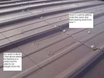

i wonder if the water is getting under the seam from the last piece of metal roof and then leaking down between the roof and tar paper and then falling in between the support box and frameing ?

That water puddle on the screw head is a good indication of the problem. This is the wrong flashing for metal roofs. You want no puddling at all. They make special soft flashing for standing seam roofs. For your roof it looks like part 9449DSA would be the correct item. They also make silicone boots for this purpose.

The roof cement is not going to adhere to the silicone> Water will run between the two and find any pinhole there may be.
Typically, the part of the flashing on the high side should have been slide into a slid cut horizontally across the roof panel(s). That was it is not "bucking" water as the water runs down.
The more crap you cake on there, there more damning and problems it will create.
Those screws holding the roofing down should have neoprene washers under then that sandwich between the roof and the screw head when you tighten them down., Be careful not to overtighten them, otherwise it won't seal correctly. Just like overtightening a gasket, which warps the gasket and can create a void in the seal.
Roof cement n metal also will not hold a seal very long. It will break lose due to the expansion & contraction of the metal.
