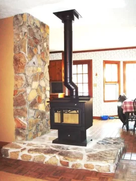

If the rest of your flue is straight through the roof, I would put the 45's closest to the stove. That way, you will have the ability to run a cleaning brush from the top further down before you get to the 1st 45. This is how mine turned out.
  • [Hearth.com] Duravent Offsets DVL -- where to put them?

I have my offset low, Rick has his high. Both work.

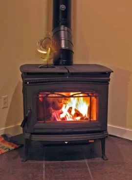

We tried it both ways, my wife and I liked it low better. The mass of the stove balances the visual weight of the offset. If you and your wife go through the stove gallery pages (navigation is at the very top of the page), you'll see several examples of offsets, high and low.
https://www.hearth.com/gallery/pics/woodcoal/index2.html
