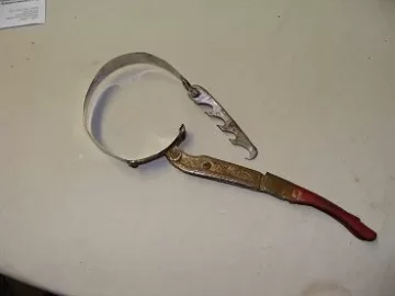

Went to take cap off exhaust and duh, I silicone sealed it on.
I grabbed this old oil filter wrench out of garage and woohoo, it worked like a charm on the 3"
duravent pipe.
I'm not sure if they still sell this type, but it made the dis-assembly a piece of cake!

I was thinking about getting these since it'd be safer in not damaging the pipes.
I use an oil filter wrench on mine as well. I just go gingerly as not to warp it.
Yup, a strap wrench is what I always use. With a rubber strap it easily conforms to any shape and grips perfectly. I also put two 'witness' marks across the joint so I know when it is fully open and fully closed.

I use an inexpensive rubber strap wrench to remove my clean-out "T" cover. Works great.

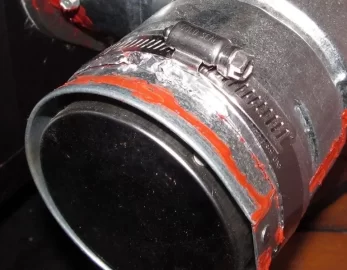

No wrench needed for the way I did the clean out cap, comes off easily by hand. Made a "gasket" by folding over aluminum foil to about 6 layers of thickness and long enough to wrap the circumference of the vent pipe. To the aluminum foil I smeared a coating of high temp silicone to one side and let dry. Wrapped around the clean out joint and tightened an O-ring clamp around it. Presently looking for a better high temp flexible gasket material, but this DIY gasket seals it with no smoke leaks.

I think the oil filter wrench is the best idea being it is completley round
the strap wrenches appear to have flat spots on the handle which may crimp the pipe
