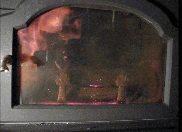

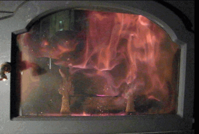

I have a Dutchwest 2479 - non-cat stove that is giving me burn problems. It is backpuffing and burning very fast.
First of all I just had the flue and the stove cleaned as it was backpuffing and the sweep found some blockage at the very top of a 3 story 6" SS flue. This resolved the backpuffing and lazy burn for a few days, but now it is doing something similar.
My initial burns start quickly and I am able to close the damper and turn down the air in short order. Once the firehas a nice layer of coals I add 4 -5 pieces of wood, I let it burn with the damper open for 5-15 min. At this point it is fully engulfed in flames. I close the damper and leave the air completely open. After 5-10 I close the air about 1/2. in short time the flames can be seen and are pretty active, then a group of flames rise like a cloud and sort of explode (mild infact). But this situation was leading to the stove backpuffing before I had the flue cleaned. Now I'm thinking it is going to backpuff smoke again. It seems like it is just on the edge of doing so.
Also, the 4-5 pieces of wood burned into red coals in 1 hr 45 min, I'm thinking this is way too fast but if I turn the air down any more the amount of flames that explode just gets larger. This makes me pretty nervous. I'm thinking of calling the sweep back but I'm looking for some opinons.

I have attached a couple of screen shots for you to see the kind of flames I am talking about.

I don't know about the backpuffing issues but as far as the mini-explosions...I had the same thing happening to my 2479 when I was on the brink of actually "everburning". Meaning, the temps weren't quite high enough to fully engage the everburn. I would assume, as the mini-explosion occurs, there is a rumble from the stove too. The rumble probably comes and goes with the explosion. As suggested, if you aren't monitoring your temps, you should be. Folks that currently run that set-up can give you an idea of the temps needed to fully engage the everburn. Just my two cents.
Get a stove top thermometer and install on stove top per your owner's manual. Let us know how hot you're burning.
Low burn temps and too little air may've caused flue blockage again. Three stories is a pretty tall chimney and gives plenty of time for cooling and creosote formation if exhaust isn't that hot to begin with or if draft is poor.
If you're getting mini-explosions causing smoke to come out of the stove, that's from an accumulation of wood gasses igniting. You probably have too little air for sustained burn.
1 hr 45 min is probably not an unreasonable burn time, given the small size splits in your photo.
