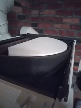

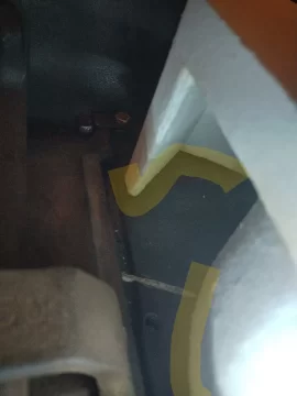

Rebuilding a Dutchwest and bought a new cat and refractory. The new refractory hugs the cat and doesn't fully rest on the inner top plate - it has three posts that rest on the cat. Then there's close to 1/4" gap between the bottom of the refractory and the inner top plate - it's floating. Is that how it's supposed to be?? Pics below, highlighted the gaps if anyone wasn't sure exactly what I'm talking about.

Think it's alright for the refractory to rest on the cat and float like that? Maybe I should trim those posts down so it sits on the inner top?

Everything telling me that the original cat was also 2". Does anyone think I should cut those posts down like 1/4"? I wish someone could chime in that installed a new refractory in one of these before. I'm thinking it doesn't make much of a difference because the purpose of the refractory is so the top doesn't overheat and warp?
I would be worried that trimming them down would restrict the flow out of the cat to much
I was thinking the same thing but it's just a quarter inch. Either way, having the gap across the whole bottom shouldn't affect anything, I don't think it needs some sort of tight seal. And over time it will likely disintegrate on it's own I'm thinking, to where it eventually sits on the bottom anyway.
