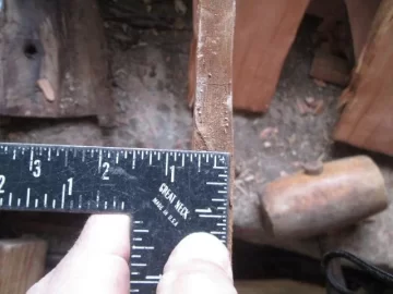

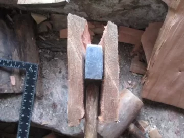

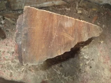

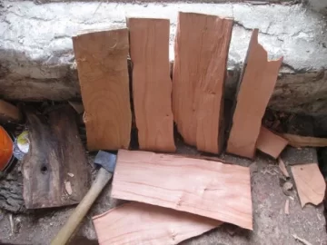

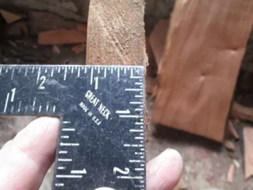

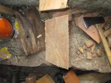

Ok, I had some vacation time to use and I don't need much of an excuse to hack up a piece of wood for any reason.
I took two seasoned cherry splits from the pile, both on the small side. I stood them on end and put my small hatchet on top and struck them 3-4 time with a wood mallet. The blade rode the grain but I got the slabs around just over and inch and re-split to about just over a 1/2". I bet white cedar being softer with a straight grain will work better. Sorry if I hijacked this thread.
[Hearth.com] DYI grilling planks
Two whacks into it.
Splitting it down, getting a little squirrelly.
Down to where it should be.
Two splits and a few planks out of them. The word is rustic here.
The pork won't care what the planks look like.
Maybe I'll get some pics of the final product this weekend. I can almost smell it already.

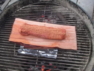

Ok, here is/was my lunch. Pork tenderloin with rub, on a cherry plank.
Before cooking.
