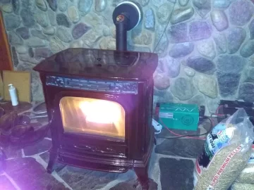

I have the dubious pleasure of owning a Breckwell Big E, and for the constant effort of owning said machine, I might as well just have a wood stove!

I don't think it's a matter of the vacuum switch dropping out, (i jumpered it for a few tests) it seems more that there is more air (and therefore a faster burn rate) of a very few pellets, than the very few pellets can sustain. In watching it till it dies, the fire dies down, and a few pellets trickle in, and it flares up for twenty plus cycles, but each time there is just fewer coals available to light the fresh charge.
If I set the airflow to a sooty burn on 3 then the coals survive (and the flame looks nicer on low) but eventually the soot blackens the glass, ... but the flame persists.
Also it seems that the cool down period is remarkable! After a charge is delivered to a dead coal bed it will continue to run (and dump new charges) usually till half of the burn chamber is filled (overflowing if a heat call from the tstat occurs !) before it shuts off.
