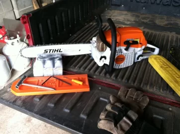

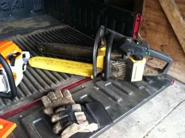

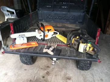

Hey, I finally unloaded the pics from my phone (man, just a few years ago that would have been a very odd thing to say...).
So here is the picture proof that the new Stihl MS261DID happen! And my Mac 610 is included just for nostalgia...

Dang, that's like parking a gremlin next to a porsche
Hey now, that Gremlin got me through a lot of wood over the years. But yeah, you ain't wrong! ;)

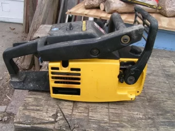

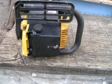

what is the crap in front of the handle bar on the mac?..... a safety shield?
That's one of the 2 designs of chainbrake/handguard the 610 had.I think its the later version,I dont see it as often as the more common one like my old beast had,it looks more like more 'modern' ones pretty much....
*sniff* ;em I miss the old beast now....It sat under bench for 11 years,filled the tank with fresh fuel,it fired right up.Sold it along with NOS 20" factory bar & NOS air filter still in the bag March 2011. I'll get another one someday,lots of them still out there.It was loud & heavy but pulled a 24" b/c with authority.
