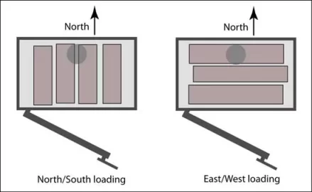

I have to admit this post is confusing. It sounds like the poster has the compass rotated 90 degrees.
I took the liberty of cutting my wood down in length and loading east to west instead of my traditional north south.
The Striker's firebox is wider than it is deep I think, so this would mean that the stove was more responsive burning north/south, more like a boxwood stove.
Yup, you're right BG. Methinks maybe rad is just starting to use it as it was intended... which would explain everything.
From the Lennox website for the C160, the firebox is 18" wide and 14" deep.
But... why did he have to cut his wood down to do E/W? Confusing.
I think he just got the terms reversed. Here's a drawing for rad.
  • [Hearth.com] East to west burn small insert
BG, remove the confusing "North" and the arrow and that will clarify things.
Assuming the air comes in over the door, that is :)
Maybe you should put it in the Wiki? The topic certainly comes up enough...
